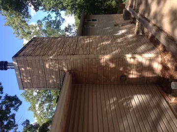

Hi Pen. It's been a few years since I installed it but if memory serves, it was 13-14 feet up from the T. We've never had a problem with draft. Cosmetically it can't get much worse as the siding and frame is sagging and looking nasty. The pic I'll attach below doesn't really show how bad it looks. The pan on the top won't clean up with a pressure washer and the inside is a mess of hanging fiberglass batt insulation. Theres a chipmunk highway inside as well, it's just a mess. I'd prefer to have it gone but I don't want to be rash. I do not currently have a fresh air intake for the stove and I would like to add one. It's a century brand stove that I got a few years back from a friend. He bought 4-5 of them at a spring clearance at lowes and I bought one for 300 bucks. It's been a good stove so far all be it a bit small.

Absolutely nothing wrong with the pipe exposed. It is manufactured to be exposed if you want [the elements won't hurt it, I mean]. Some people don't like the look of shiny, exposed pipe. I've never understood this, myself.
