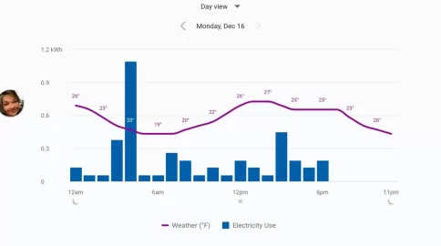

What kind of daily usage are you seeing, if you don't mind me asking? Right now we are around 11.5 KWhr/day average. I'd really like to get down to less than 9 KWhr/day
About 24kWh/day at this time of year. My wife is baking stuff for Christmas, heat pump comes on some times, winter lighting, electric HW and clothes dryer bring it up a lot and we charge the car too. Summer drops down to about 15kWh/day including car charging.

I love data! MY natural gas hot water heater is over 10 years old so I feel it should be replaced soonish. I’m not sure I wanna commit to electric on this yet. I briefly looked into on demand electric water heaters, wow those need some serious juice!

Thanks for the data points. This makes me confident we could live with solar for the majority of the time.

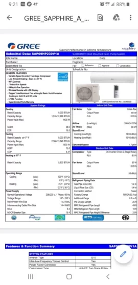

The technology is advancing rapidly using vapor injection compressors. My Gree is AHRI rated at a COP of 4.47. I believe that is a seasonal rating as most mini splits arent running in subzero weather all winter.
My Gree can put out almost its full rated output at -22 as well.

I looked up that GREE unit on the NEEP site using the AHRI number listed on the catalog cut
(broken link removed to https://neep-ashp-prod.herokuapp.com/#!/product/25405)
Note the COP down in the colder temps, quite a difference between 4.47 and 1.85. I don't dispute that an air source minisplit COP is great for milder winter temps and its a fine supplemental heat source. I also note that if I plot the temps verses COP the trend line looks to hit 1 long before its gets to -21 F. Granted there are only three data points but the trend looks like a baseboard heater for heating up a spot location beats heating the entire space with a minisplit somewhere around 0 F.
The NEEP Semninar goes into why the ASHRAE values were not useful for units in colder climates.
Standard heating practice is to size the heating appliance for the design cold temp steady state outdoor air conditions. Using that basis there is the option to install multiple minisplits to deal with winter design temps but unless the far lower COP is factored in the homeowner who uses a seasonal COP is going to be quite cold on that cold day as they will be short 60% of the expected heating load, thus the recomendation that in cold climates the minisplit should be regarded as supplemental versus a primary heat source.
