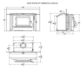

My current setup is a fireplace that is 23" deep, 33" wide, and arched starting at 21" on each side, and ending at 24.5" in the middle. The insert that requires the least brick demolition, yet from my scouring seems to be recommended for good heat output sans blower is the PE Summit Insert LE.

you'd have to do some measuring but maybe a BK princess? It still works better with a fan but someof it sticks out of the fireplace so you would get more heat then a normal insert. Its box is 23 3/8" tall tho. Depending on the arching it might fit. Measure your height at 13" from center on both sides. The Princess box is just under 26" wide

The Summit or Princess would both work out. So would the big Osburn 3500 if it fits.
As a general rule, the more an insert sticks out onto the hearth, the more radiant surface is exposed. There used to be a nice medium sized insert made by Regency called the Hearth Heater that did this well and the Hearthstone Homestead sat entirely out on the hearth. Both were discontinued in 2020.
