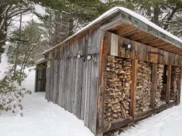

I have a pretty boring woodshed with a simple roof design . . . rain and snow hasn't been much of an issue here in Maine . . . guess the overhang is long enough. On the sides and back I have a board and batting design . . . minus the batting. Once again, rain and snow penetration isn't much of a factor.
Mind sharing your plans for that if you have them? If not, dimensions?

Give me a a day or two . . . no plans . . . pretty much just did it as I went along. Used some footings from a giant swingset the former owners had in the backyard. Used scrap dimension lumber partly from an old camp I tore down with 2 x 4 walls and board siding . . . 2 x 6s (or maybe they were 2 x 8s) for the rafters (bought that wood).
No worries on exacts, rough dimensions would be cool. What's that overhang on the front, 18"? 48" between posts on the front? 1:4 pitch?
I've got a whole bunch of scrap lumber around here, I plan on using that as well :)
This is still on my "to do" list.
OK, I finally trudged out through the snow and got a few measurements for you.
The exterior dimensions are 12" 6' x 21" 6' and approximately 7 feet high (I was using short 2 x 4s . . . otherwise I would have built it at 8 feet.)
Obviously the front of the shed is higher than the back . . . about 2 feet taller. I didn't really go with any set pitch which I probably should have . . . just went with what I thought seemed decent and would be easy to stand on to roof.
Overhang sticks out about 2 feet . . . which you would think wouldn't block that much snow or rain, but I honestly get very little snow or rain penetration unless we have a Nor'easta or other blowy storm pass through.
It's about 5 feet between the front posts. I'm not sure why I didn't go every 4 feet which would perhaps made more sense . . . maybe it was for aesthetic reasons . . . in any case . . . it seems plenty rugged enough.
Rafters are 2 feet on center in most places . . . I doubled up on the outside edges and I think I had a couple of extra 2 x 8s so I threw those up as well.
Wall 2 x 4s are roughly 2 feet on center with some posts doubled up . . . I'm not exactly sure why I did that . . . although I am a firm believer in over-building things.
I hope this helps.
Photo 13: Front view. This is why I don't fret about how much longer Winter will last . . . this shed holds at least two Winter's worth of wood. Not pictured are my snow covered stacks outside seasoning.
Photo 14: As you can see despite being open in the front and having no batting the shed does a decent job of keeping snow and rain out . . . there was a little bit of snow in the back and front when I took the shot this afternoon . . . but this is after Thursday's Noreasta . . . and it has been pretty much snowing on and off since Thursday. Usually I only get snow when it's a very windy storm.
Photo 15: Inside side. No snow here at all.
Photo 16: I purchased the 2 x 8 boards and pine boards for the roof as I eventually ran out of the reconditioned wood I was using.
Photo 17: All, or maybe it's just some, of the front posts are made up of three rough cut 2 x 4s screwed together. Also seen in the photo are some cross braces I left on to just add further bracing to the shed.
Photo 18: Close up view of the "beam."
Photo 19: Just a shot I took of the crap load of snow that has come off the roof. I now have to walk up the snow bank and then walk down to go out of my covered porch. Also in the photo in the distance is Catcatraz . . . and in the forefront is my metal covered ash pail located away from any combustibles.
Photo 20: Side view, exterior. I love my RAB motion sensing lights by the way. One of the best things I ever installed around my house and on the shed . . . not because I'm fearful that folks will steal my wood (although the Cylon like red light bouncing back and forth might make some would be thieves wonder if the lights also double as recording cameras I suppose) . . . but rather the lights are great when I go out in the early morning hours or late at night during the winter and have light to see where I am going. No lights in the shed, but generally there is enough light thrown off by the floodlights that I can see the wood. In the back is a sled shed my brother in law cobbled on to my woodshed.
Photo 21: Showing the 2 foot overhang.
Photo 22: Doubled up 2 x 8s on the end . . . I had a couple of extra boards so I threw them on as well.
Photo 23: Another inside shot showing the wall studs at approximately 2 feet on center.
Photo 24: Bonus shot of my porch wood which I usually restock weekly. Since it was starting to feel a lot like Spring and I was thinking in a few weeks I will be able to easily get my wood supply on a daily basis from the woodshed I have not bothered replenishing the wood supply. I did not expect this last storm . . . but I also suspect this snow will melt quickly.
