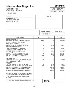

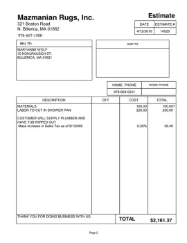

This is the estimate from the tile person.
They mentioned wanting to "work with" the available plumber, something about the drain?
I have not arranged for the tile person to be here during the week-end.
I assumed we would put in tiles afterwards.
I hope that works out.
Tim seems to think we can save money using a vinyl shower surround.
I tentatively agree but am unsure how the division of responsibility works in that case.

The tile quote looks fair and looks like it covers all the bases. The cement base for the shower is standard approach. I did not see if they included the pan liner. Sometimes it is a plumber thing (since the drain goes over it) and sometimes it is the tile guys. Check. I think you would be happier with the tile. Make sure you seal the grout with grout sealer according to the directions. Ask the tile guys which product they recommend. You can always get one of those sill Scrubbing Bubbles shower cleaner things. It works with our 19 year old daughter!
If it is okay with everyone, I would prefer to go with the tile.

Someone, probably Dune, should call the tile shop on Friday and talk to them and make sure there are the correct expectations on what will be done by whom.
Coordinate the plumber with tile guys asap. They should provide the location and height specs for the drain. Ask what is their preferred brand to use with their shower pan system. You will need to have the proper floor drain fitting roughed in and it needs to be set to their spec. This is a critical component that must be correct.
