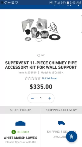

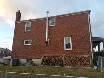

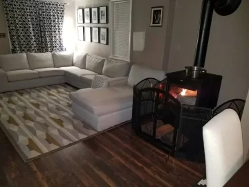

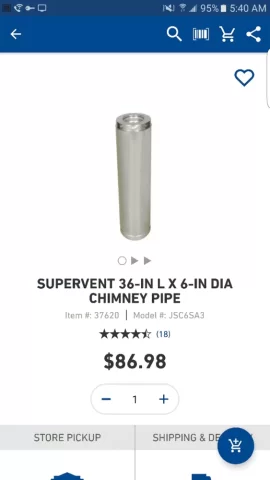

Hmmmmmm go to lowes and buy the pipe. It was roughly $100 per 3 foot section of class A 3 wall 6". It's made by supervent and is twist lock installation. Very easy.
You would either need 8 to make a 24 foot stack or buy 1 shorter section of 24 inches to make 23 feet.
Then there's the wall thimble kit or ceiling install kit depending on which way you are installing. Wall kits cost a bit more. Here's what I used. The locking rings are like $2 each and you need wall brackets every 10 ft. The wall thimble kit comes with 2 though so that gets you 20 feet roughly. If you need more they are like 5 each.
My total cost for everything including a hearth pad and the stove was 2k ( granted no labor fee..... have a contractor friend who oversaw my work ).

I corrected it. $2000 USD for everything. I wrote 2k and my phone changed it to 20 without me noticing. I DID research everything. Learning a lot on the way too. It only took about 2 days to install everything ( days off of normal work ). Looks / works great. It will pay for itself this winter :) Next winter is pure profit.

Same here. Washers / nuts on a string make a great plumb bob :) I started from the bottom up, made the whole stack, then anchored it after marking center on the roof flashing. Didn't really need any tools other than a cordless drill, a couple masonry drill bits, and screw gun tip.
On the inside I had to use my metal bladed sawsaw to cut the single wall to the right length. It was the snap lock type ( pain in the rear ) but all went well. No air leaks with a nice tight fit. Just make sure to stagger seams an inch apart.
