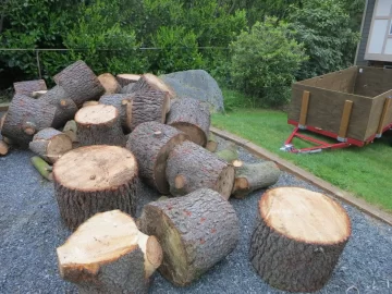

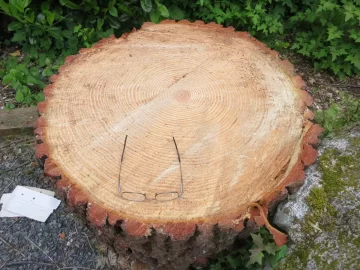

the log fairy left a present!
actually, i responded to a craigslist ad about someone that needed to get rid of some wood and would drop it off.
big pieces of pine. lots of 3ft diameter chunks. gonna be a bear with the x27.

I've split lots of pine by hand. Do yourself a favor and split them in half with a wedge first and then go at them with the ax. And do yourself another favor - the piece in the lower left in the picture and any that are similar, don't even bother trying, cut it into 4 inch discs and then split those in half.
X2
I wouldn't even swing the maul I would cut them in half with the chainsaw first. Just slice them half way even No need to completely cut in half.
