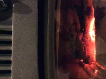

Brother Bart thank you for your input, let me make sure I understand it correctly. That spot on a stove body between frame of the door and the grill shouldn't be more than 350-400? It would be that black part on the pic.

Just saying what I have observed on both inserts and free standers. Both where I had measurement access to the top plate and the front of the stove. And if the blower is running it is another whole different deal.
