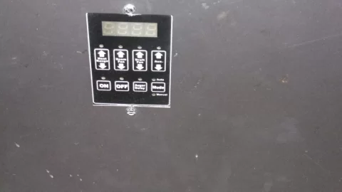

I picked it up this morning. Been used and abused. Don't look bad on the outside, inside is another story entirely. Checked the 4 button board, all good, but the combustion fan sounds terrible and when I pulled the backer board, the left side cleanout is completely filled with crusty ash. Obviously, the owner never read the instruction manual, probably used it for kindling. Inside it's a mess but all fixable. I've already bulled the door, I'll replace the door gasket and window gasket too. All the guts will come out and get refurbished. Convection blower reworked with skate bearings, combustion blower with skate bearings, all drive motors will get cleaned and lubed as well.

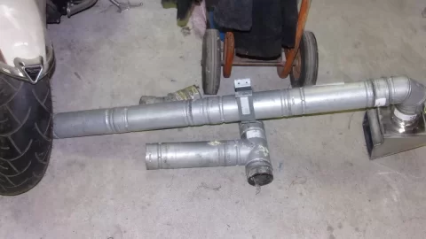

He had the venting laying there. Asked him what he was gonna do with it, he said in the rubbish so I got all the venting, the standoff's and the delfector hood plus 15 bags of Michigan Hardwood pellets.

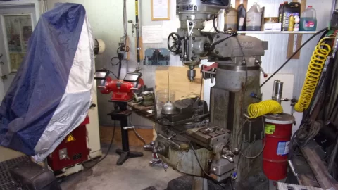

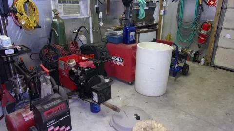

Coming, before (ugly) and after (hopefully cured). Nice thing about pictures is, you'll get to see all the machine tools and fab equipment in the shop as well. I always like looking at pictures. Usually not for the subject but for what is in the picture besides the subject. Digital camera is all charged up and ready to go....lol

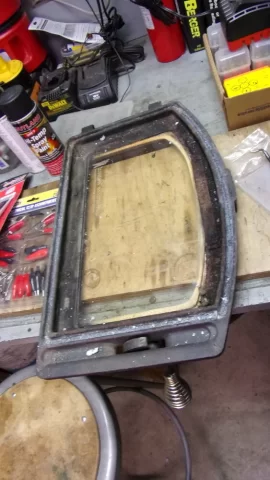

Ordered a new glass gasket and picked up a new 5/8 rope door gasket and 2 cans of HT black stove paint at TSC yesterday. I won't now what internal parts I'll need until I start taking it apart. Hopefully nothing, but we will see. I've got my fingers crossed that the HX is ok. If not, I'll have to weld it. No big deal, have all the tools necessary.

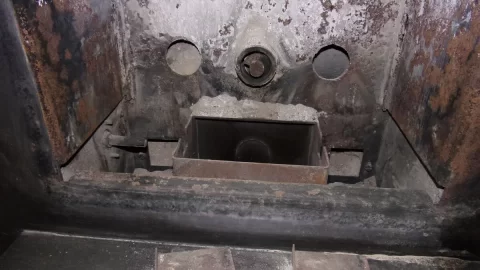

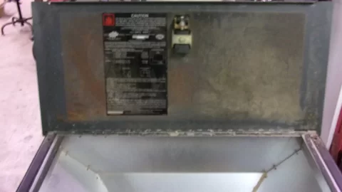

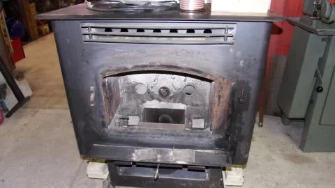

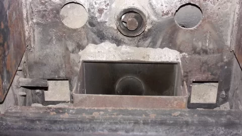

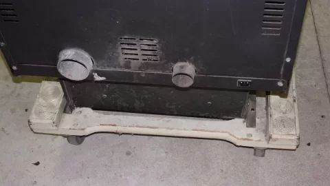

As promised, Not a big picture taker but here they are. Note the amount of ash inside it. Don't see how it ran actually. I imagine as I take it apart there will be surprises lurking under the side panels. I plan on wire brushing out the entire firebox inside, cleaning out all the ash, going through the drives and gearboxes and adding grease ports to them. I already have machined a new stirrer bushing with an extended (in the firebox) end, I made a couple when I made on for my in the house unit. I'll do progress pictures as well as I get to discover just how bad things are under the panels. The side panels are in good shape as is the top and pellet lid. Needs a new gasket underneath, I'll replace that. I'll flap wheel the entire front and add ceramic pull knobs to the clean out slides and paint the entire front as well. The loading lid has rust on it, that will also get refinished

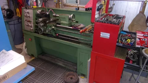

Like I said, as I tear into it, I'll take pictures and post them. Added a couple pictures of part of the shop for your enjoyment too. I have more tools, so many I sometimes forget where I put them....lol

ETA: Nice shop set up!
