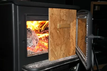

I had a PE Super 27 for 5 years. I got a PE Summit last spring ( both pedestals). My Super 27 was a smaller firebox of course and I never had smoke come out the door when refueling. I always had excellent draw. When I installed my Summit, I raised the stove off the floor 1 foot so I lost that much pipe. In addition the firebox is bigger so it requires more draw. I added another 2 feet of Class A pipe to the chimney which helped, but on milder days, I still get a little smoke in the house when reloading. I HATE any smoke in my house. I've been spoiled by 5 years of not having to worry about it. People would come over and say" I would have never known you had a wood stove going". No smell outside or inside.

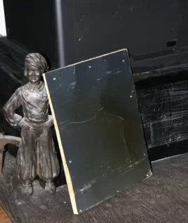

Soooo, I came up with a very high tech solution. I got a board, screwed a smaller piece of wood to it, then screwed metal on one side ( the metal is the high tech part). When I open the door to reload, I slide the wood in front of the door (covers about half the open space)thus reducing the amount of open area and I get virtually no smoke in the house. It's really not even an inconvenience using it. I can load the stove easily with it there.
Don't anyone even attempt to duplicate my invention. It's just too complicated.
Edit: I set the "invention" there while the stove was going only for picture purposes. I don't reload the stove until the coals have burned down.
