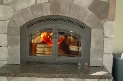

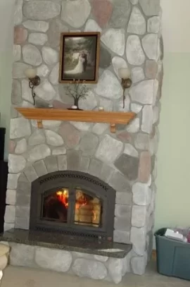

I have a solid granite hearth and I have to say......it rocks :)
Seriously though, we got the polished granite it looks real nice and holds up well. We always get compliments on it. Also, the polished is easy to clean(no cracks or crevices to get gunked up), just bruch off into a dustpan.

Here are a couple of pictures, I'll try to post something better when I get home tonight.........
Y
