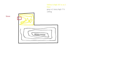

Given that the yellow part is high ceiling and the rest less so, a fan on the ground pushing cold air to the yellow room is best to get heat in the other room. The air removed will have to be replaced by warm air from the yellow room.
It'll be hard to move warm air by itself because it'll pool at the ceiling.

you say that heating goes well not in terms of circulation. But where is the heating source located for this working situation?
A stove is a space heater; it provides heat at one point. Circulation is then much more important than e.g. using distributed baseboard or ducted heating.
If you buy a big stove, it's imperative to move the heat otherwise you may cook yourself out of the stove room. For that an "air circuit" (so the air can flow in a circuit) is best. Given that that is not possible here, from what we see, the best is to create a "hot-cold" circuit. Move the cold air along the floor to the stove, which will automatically be replaced by colder air flowing the opposite direction higher up. In the grey room that'll then mix down because you are taking away air from the floor.
