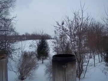

The load gasified from the get-go, flue gases were transparent, and rate of heated water production was greater than normal (due to higher flue neck setpoint).
Certainly there was a certain amount of live steam going up the flue, but it hardly seems as disastrous as I would have expected.

stand downwind from the smoke & cop a smell?
There is no trace of smoke whatsoever, so no smoke to smell.
The gasification jet photo does not do justice the to the true iridescent whitish blue flame. It's burning as bright and clean as you could ask for.
