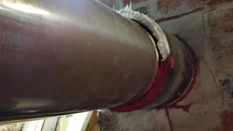

I have a E180 and I find it a constant battle to keep everything sealed up in terms of smoke leaking out. I have the boiler in the basement in a very well sealed boiler room (exterior door with weather stripping between boiler room and living area, spray foam for all water and wire passages etc...) with walk out garage door. I recently discovered that by leaving my smoke exhaust hood on 24 hrs/day and keeping the boiler room at a very slight vacuum all hints of the smell are gone from the rest of the house. I have a fresh air intake so this does not affect the burning process. I find the high temp orange silicone has burnt off several times and in my opinion is an extreme fire hazard. My wife went into the boiler room to see big flames from the burning silicone. I made the entire smoke pipe from tig welded 16 gauge stainless but I have to come up with a better solution where it enters the brick. Also I need to come up with a better intake pipe system, I am currently using 6" metal ductwork and screwed and duct taped but several times this has blown apart due to the explosions upon hot gasses igniting at startup. I was thinking 5 or 6" PVC possibly with glued elbows. I have included a pic of the silicone after it has burnt, it turns white and flakes away like powder. I find this has happened after closing the the intake damper to stop the chugging, this leads to a rich burn that sends unburnt charcoal bits into the flue, this collects and burns in the smoke pipe reaching extreme temperatures. In the pic my 6" pipe is approx 6" inside the 7" and the space between is stuffed with rope gasket and high temp silicone but eventually the silicone burns or detaches and the smoke still leaks out when it starts chugging. As for the center fire bricks, I have been making them from 5/8" thick steel and they last about a year, I then fill in the eroded areas with my mig welder and they are good for another year.
  • [Hearth.com] Wood gun Operation questions
