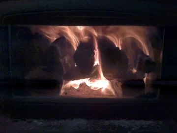

Here's a fire in the Summit. :coolsmile:

  • [Hearth.com] Greetings and SUMMIT INSTALL
Oooo, that's a really nice shot. Hmmmm, heat.
