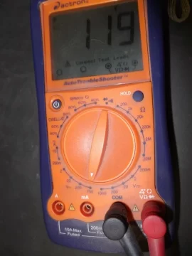

OK, I removed both grey wires from the phase controller and put probes on the phase controller prongs to try and measure resistance across it (in Ohms). Hopefully I did this right. Across every possible selection of Ohms I got no no reading. 3 questions, 1. Did I measure this in the proper manner? 2. Is the tool I used appropriate/the selections on the upper right correct to try and measure the resistance? 3. With no reading, does this mean I need to replace the dial a fire or is there a seperate potentiometer I am unaware of? Here is what I used to measure with:

you want to measure volts (vAC) to make sure power is moving from 1 component to the next. That meter will do just fine for everything, no worries.
