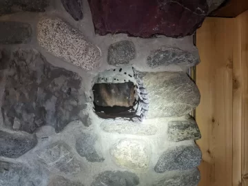

This is what I just did the other weekend. Through a decorative rock wall, then cinder block then terracotta flue. Worked well didn't make it perfect because it will be hidden by the trim ring. Just needed a 24" bit to get it done. Picture below:

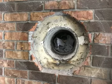

It will be interesting especially starting later in the year than I should have. I’m guessing their will be a 2nd mess cleaning out the mortar between the two walls.

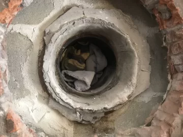

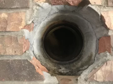

Would the next step be to light tap the mortar from the chimney wall? Looks like it has a 10 inch clay tile in the cyinder wall with mortar installed inside of it to get down to 8 inches where it meets up with the 8 inch tile 3 inches back in the chimney. It’s 5 1/2 inches from inside wall to chimney wall also. Thanks.
