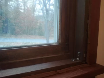

This is such a great post to read! We bought a super drafty old house and we are heading into our first winter. We've only been here a few months but we are frantically tryign to get it air sealed and insulated ASAP. I'm interested to hear more about what you did to build the storms? As much as we love our house, full of light and windows, they are drafty and old. WE don't want to replace them, since they are beautiful antiques but adding storms will definitely help!

Here's a couple of pics of the interior storms -- it's framed with 1x2's - nailed on the ends with a 90 degree angle screwed in at each corner to give it strength. Vinyl stapled on and wrapped over each end -- and for the final seal some window insulation cord to cover any little gaps. I found the vinyl at home depot in the section where all the weatherstripping and window insulation is - it's called something like super clear vinyl or poly-vinyl - can't remember exactly - it's 4 mil but still easy to see thru. I found that each piece had to be custom fit as one side or the other of the windows was off by 1/4 to 1/2 inch on the sides and top to bottom. I made them pretty tight so it takes a little push to get them to slide in.
