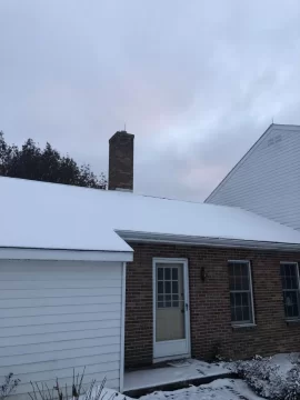

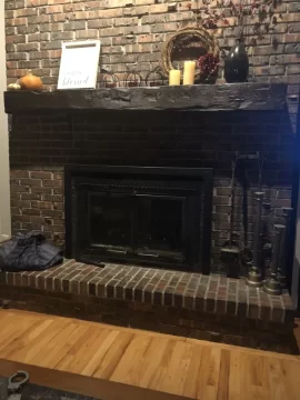

House is new to me. Chimney is 8ft high.:
[Hearth.com] Hampton HI300 Insert Install (pics)
Old Fuego insert was in the fireplace. 1979
Fuego Removed:

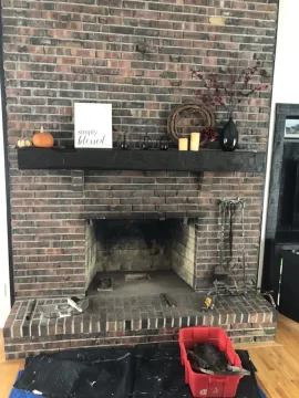

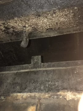

Damper was missing and Chimney looks nasty:
[Hearth.com] Hampton HI300 Insert Install (pics)[Hearth.com] Hampton HI300 Insert Install (pics)[Hearth.com] Hampton HI300 Insert Install (pics)[Hearth.com] Hampton HI300 Insert Install (pics)
Damper Cut out. Took 3 minutes with a Sawzall:

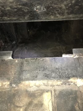

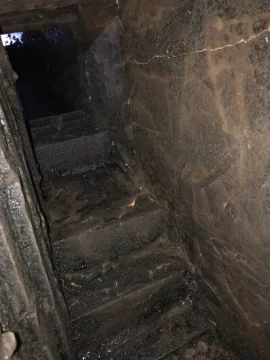

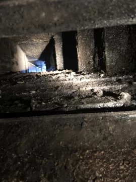

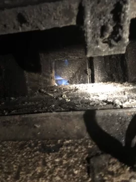

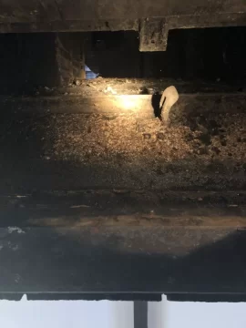

Spent the better part of the morning scrapping and cleaning the smoke box.
Pretty much as clean as I can get it. Would a Chimney Sweep do any better? The quote I got was $230. Trying to save money and I really don’t want to pay a guy to come here and tell me he can’t get it any cleaner. I scrapped with a hoe and various brushes. All the big stuff is out. Looks like level 3 creosote gel is the only stuff left. A light coating on most areas of the smoke box. Think I am good for the liner install?

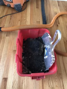

This is what I scrapped off. This doesn’t include the 5 gallons of crap that was up on the smoke shelf. Real lucky this house didn’t burn down:

Oh... so the iron baffle wasn’t too bad to cut out? I have to do the same with mine.
Save the cut out piece, maybe put it under the insert or at the back of the fireplace so that a future owner has the option of welding it back in if they so choose.
Fuego Removed:

I would get it allot cleaner than that
Not at all. I was dreading it and was happy to see the sawzall went threw it like butter. I was a little gentle with the firebrick, but I think once the insulated pipe gets here I will have to chip some of the firebrick back.
Any advice how? I scraped it with hoe and then a hand scraper and then a floor scraper. After that I used a steel brush. After that a poly brush. After that vacuumed everything. The pics are deceiving. A lot of what appears to be caked creosote is actually mortar. That said, there is most definitely a thin glaze of shiny creosote on almost everything. Any advice?
How hot will my insulated liner get?
I would clean it with a rotary cleaner with chains on it to chip the glaze away. If that didnt work then it needs chemicals.

How clean does this smoke box need to be??
No offence taken there are sweeps who do take advantage. But you concerns about a paper trail are unfounded. Yes they will document things but that paperwork is not submitted to anyone. It is for your information and to protect them from liability.
The smoke chamber in my opinion is not clean enough. But it will probably be ok especially if you are stuffing with roxul. But from what I can see the flue will probably need cleaned with chains.

Bought the soot eater and gave the chimney another clean. Probably took another gallon of creosote and crap from the chimney.

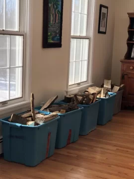

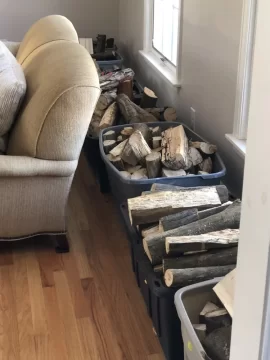

Spent the last 2 days cutting dead standing trees (cause I have no wood for this season). Brought some of it inside to get the snow melted off it.
[Hearth.com] Hampton HI300 Insert Install (pics) [Hearth.com] Hampton HI300 Insert Install (pics)
Surprisingly I am getting a 17-20% moisture reading on most of the split wood. Stoked about that. Some are at or around 25%.

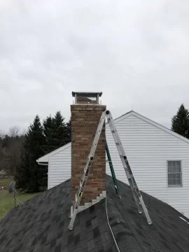

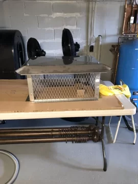

Chimney cap came in:
Any dead standing you can find with the bark fallen off and under 8" is going to be pretty dry.

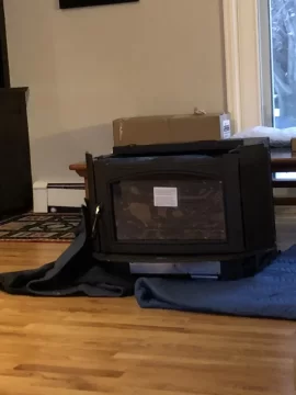

Picked up the insert today. Jerry rigged a rope and used the tractor to get it out of truck. Knocked off the wood from the pallet and threw down a heavy blanket and jimmy'ed it thought the garage door into the house. Dragged it over to the living room.

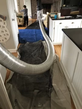

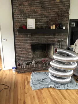

Liner arrived. Went with the bottom up install.:
Kind of a pain in the butt. But got it done fairly easily. I did buy the pull cone. Not sure how I would have got it done otherwise.

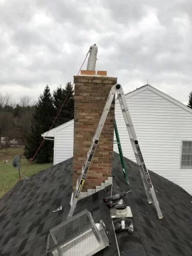

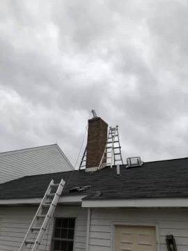

Chimney Shot:

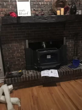

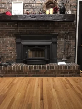

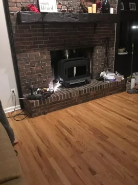

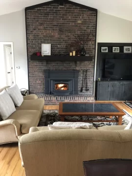

Unit installed:
Now this was the biggest pain in the ass. It was just me and my wife and while not that bad at first, I was having a hell of a time getting this thing in place. After struggling for 30 minutes I realized that the back of the unit was hitting the clean out tray in the fireplace! I felt like a moron. Easy sailing there on out.
Side panel in:
Done!
Chimney Cap:

If you don't want that floor in front to get burnt by popping embers, you may want to get a hearth rug or extend the hearth.
