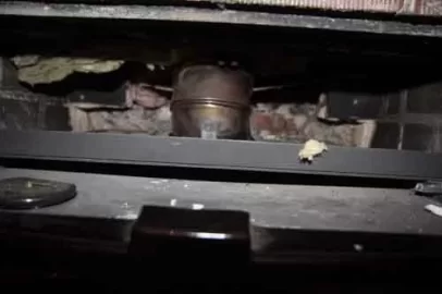

You can see the 1.5 courses of firebrick missing. I know I could at least get the lower course in. Behind the liner is the masonry part of the chimney which normally is behind the fireplace firebox. [Hearth.com] Hampton HI300 Install
I would probably put the lower course in with some proper mortar and then fill what you can't get with Roxul. I had to remove the top middle two bricks to get a straight drop for my liner also. Then I stuffed like 1.5 batts of Roxul up in the smoke chamber. I actually made a template with cardboard and then made a blockoff with 1/16" galvanized metal. It was too tight after the fact to put it up so I used the actual block off as a template to make one from Roxul. I stuffed it up there and has been there ever since.
I think I might have a sweep come install the plate, clean the liner and inspect the install. I can't get the insert out of the fireplace without screwing up the floor and my back. Plus we have a 10 month old and my wife would be much happier if I had a pro check everything out!
Or maybe I'll do the bricking, insulating, block off and have them come inspect it! thanks for the advice.
Can't go wrong with that!
The block off will definitely help in performance but wood that is not seasoned will really hurt performance.
A soft block off plate or rockwool was installed by me. I couldn't really bend the sheet metal to fit, and the rockwool seems to be staying put. Between that, the insulating I've done and the seasoned wood we had the whole house up to 70 with a small fire. We have an 11 month old, so I'm only firing after she goes to bed until I acquire some protection to put around the stove.
