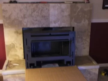

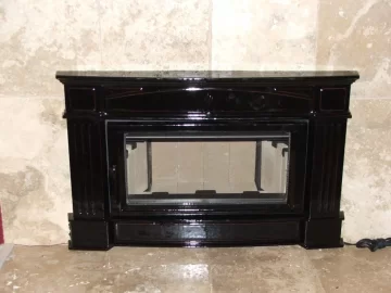

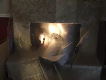

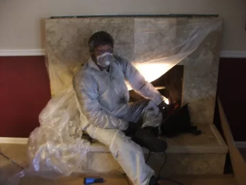

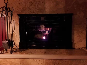

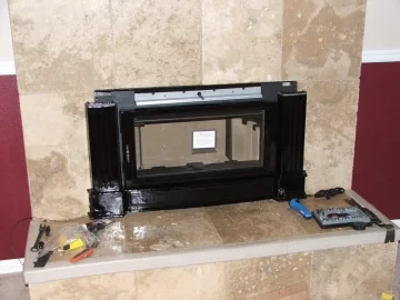

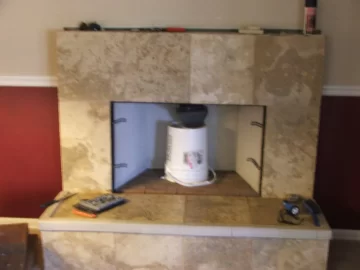

Whew, finally got it put in!!! Ran into a few problems and worked late into the night Saturday but she's finally there. I think it looks pretty good and the wife loves it. Sorry for some of the blurred pictures, someone hasn't figured out the whole flash thing yet!

Nice unit, a little tip, if your burn time are less than impressive there is a air restrictor for that unit and make sure the knock outs are removed in the shell.
Make sure the wife cleans all those fingerprints off that nice new enamel...:p

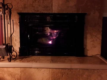

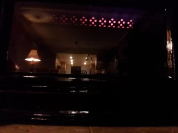

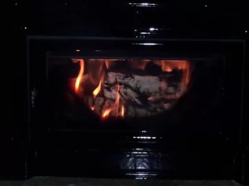

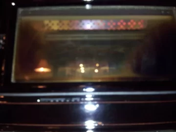

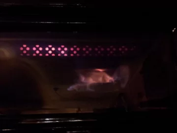

Quick update! Well, it's been in the low 30's to low 40's since Thursday and the insert has so far exceeded our expectations!!:) The house has never been warmer. I'm consistantly getting 10 - 12 hours of heat from a load and have hit the 14+ hour mark three or four times since installing:cool:. Grant it, the CAT is NOT at temp this entire time and there is no active flame for most of it but I'm still getting good heat for that amount of time. For those that are curious, I don't consider the loading/firing or heat up time before I engage the CAT in these times. That is actual time that we get good heat w/blower on AFTER I close the bypass.
Overall, the wife and I are very pleased. So far, the only complaint I have is with the glass. It's a huge window but it's pretty black right now. I guess that's a price I'm willing to pay for those kind of times!
[Hearth.com] Hampton HI400 Installed!!!! [Hearth.com] Hampton HI400 Installed!!!! [Hearth.com] Hampton HI400 Installed!!!! [Hearth.com] Hampton HI400 Installed!!!! [Hearth.com] Hampton HI400 Installed!!!!
Not the best pics but you get the idea.
