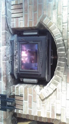

Coals
  • [Hearth.com] harman 300i help
Flue temp is 252
Not bad, with the stove still at 550. So sounds like me, you're only getting those really high flue temps early in the burn. Which isn't surprising if you consider the AB is probably at 700-800f with lots of combustion air getting pulled through!
