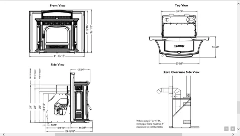

You should be able to get a measurement from th top of the surround & determine which hopper you have based on these pics...

I saw these measurements in the manual, was trying to avoid pulling the stove out of the zero clearance box.

You can't figure out where the top of the hopper is?
Measure down from the surround & that will get you close.
You don't have to pull ANYTHING out.

Mine is the 24" depth hopper and it holds about 1.5 40lb. bags. Measured mine when I installed it.
I have the 52i. If I burn down to nothing and refill, I normally put 45-50 lbs in to fill er up. Hope that helps.
