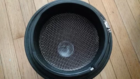

I'm fairly certain that this large (what is it? 1/8"?) mesh in that nearly 3" ID tube isn't causing a restriction.

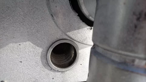

If that's a restriction then I have no idea how my <2" pipe breaths through this tight-mesh screen:

I suspect that in your case there is a short almost direct run between the intake on your stove and outside on your OAK run. I don't believe it it true for the OPs run, I'm not certain but I think the OAK run on the OPs setup has a few bends in it. Further it looks like that mesh has crud on it never a good sign. As OAK runs get longer you have to increase the size of the plumbing used. I asked for a picture so we could see the stuff behind the curtain.
It only takes a little bit here and a little more over there to screw up the air flow And in this case the intake is also higher than the vent outlet also not a good thing..

Mine has an "S" shape due to running it through the flange of the exhaust thimble, but it is less than 2' long. I have no issue with the possibility of an airflow issue, but the contribution from that loose mesh screen on that large of a diameter is miniscule.
For reference, this 5.5" diameter opening from the filter on my supercharged GT500 passes air across this much tighter mesh at 950 CFM - or greater than 3X the CFM per square inch compared to the one the OP has (I did the math :) )

A GT500 has a much more powerful air motivator than a pellet stove. Just sayin'. I have a 3" OAK, and the inlet has ¼" screening on it. So far, so good.

It's all about pressure drop - the restriction of that engine filter is small as it should be to minimize horsepower loss, and large mesh 3" is so small as to be insignificant - especially whereas I covered 50% of my tight mesh 2" OAK with barely any difference in burn.

Yes but you have a 950 CFM sucker, it is sort of like using a leaf blower to clean a pellet roaster that sucker can move far more junk and air through a lot of twists and turns than the exhaust blower on most stoves.
Which makes even a minor hindrance an issue.

If a stove has issues with long twisting pipe, then that's the issue. Each contribution is like a resistor in series - they add up. Focusing on what can't be more than a 1% contribution (that large mesh screen) can't be all that worthwhile IMO.

I will assume nothing. That is why I want pictures and the oak screen removed.
