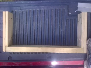

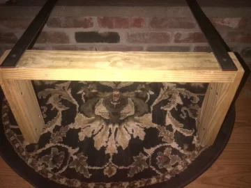

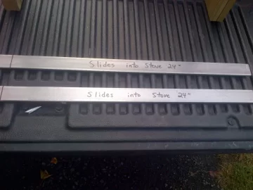

[Hearth.com] Harman 52i rail kit I used 1-1/2" flat bar cut into 4' lengths with some wood stands that I fabbed up, about $20.00 total. I countersunk the screws to recess them and also had to grind the edges of the flat bar to narrow it a bit to insert fully into the stove rails-weld/spatter inside the rails. Works great ands I disassemble my rail kit for storage. [Hearth.com] Harman 52i rail kit [Hearth.com] Harman 52i rail kit
