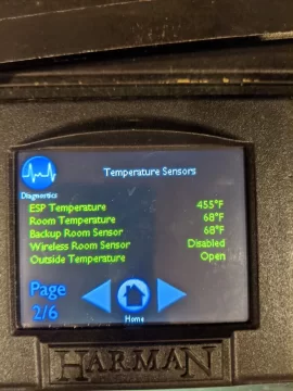

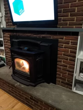

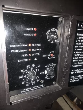

Hey everyone,
I'm writing from Rhode Island in good ol New England. Out of curiosity, I wanted to see the actual heat output, or at least what's being distributed into our house from the stove, so I took a meat thermometer and placed it right near the blower of our Harman Accentra. While the esp temp is essentially maxed out or close to it in the mid 400s, my measurement of the air blowing out read only in the high 200s (pics attached). Does this seem right? My concern is that I'm losing a lot of heat up the chimney, though I'm not sure if these pics confirm that.
I'm aware this isn't the most scientific method of testing here, but I figured it was worth a shot. Without rambling on in a long-winded post, I'll address any questions in subsequent posts, as I'm sure there are a million variables at play.
2k sq ft cape, by the way.
Thank you!
[Hearth.com] Harman accentra 52i  heat output [Hearth.com] Harman accentra 52i  heat output [Hearth.com] Harman accentra 52i  heat output

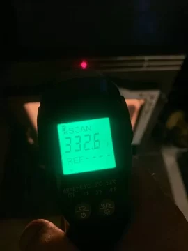

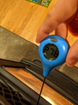

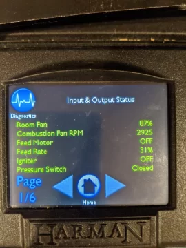

Just temped my P61A and here’s what I saw on these settings.
I’m sure if you used a temperature laser it would be higher.
  • [Hearth.com] Harman accentra 52i  heat output

I should probably invest in one of those as I'm sure they're more accurate. Thanks for your reply.
I guess I'm just wondering if I'm getting the most out of my stove. I don't believe they installed an OAK. No, I didn't know what that was at the time, and I only learned of this forum after having spent some time researching after our stove was installed, so I feel dumb now for not having done my homework ahead of time.
Our stove struggles to achieve a room temp of 70 this time of year, and when it does get to that temp, it rarely gets to calm down, meaning it will basically stay at full blast (feed limit set to 65%), which of course uses quite a bit of pellets. As a result, I'll typically set it to 68 at the most in an effort not to eat a ton of pellets. The stove runs on auto and on a schedule - 64 during the day and then 68 around 5pm until 10pm, at which point I turn it off until 6 the next morning. At this rate, we're using about a bag a day, so I can't imagine how much we'd be using if I were to leave it on manual and let it run all day and night. I'm quite jealous of all of you who let this thing run 24 hours a day and brag about a nice warm house.
I have an energy assessment in a few weeks to see where we can improve in terms of home insulation, which I'm sure is partly to blame here, but is there anything else I may be missing? Our home, while two floors, is a pretty open floor plan on the first floor, and I keep our ceiling fan running clockwise at the lowest setting to help circulate air and push the warm air down.

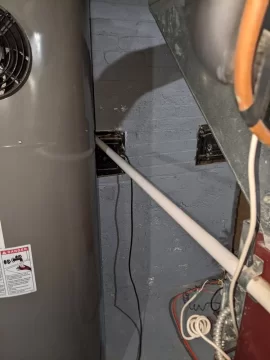

Sorry if I wasn't clear in my initial post. This is an insert sitting in the fireplace. As such, it's vented up the chimney. The more I read through the OAK threads on here, which have been very helpful, I'm very confident that the company from whom I purchased the stove didn't install an oak at the time the stove was installed. Two things, however, that make me think the installation was done a bit sketchy, in my opinion, are as follows:
First, my fireplace opening isn't "standard" size, so the insert didn't quite fit properly (stove was too small). As a result, the installer had to go back to their store and get a steel sheet which you can see in the picture. The issue though is that while it seems to fit okay, there is a small gap between the sheet and the brick fireplace, which I'm assuming is contributing to heat loss.
Second, they ran an extension cord to power the stove down to the basement through the ash pit door to a GFI outlet in the basement. This can't be standard operating procedure, can it? Also attached a pic here for reference.
Appreciate the help!
Reactions: Ssyko
Oh ok, well that changes a few things. You may be able to run a liner straight up your existing chimney next to your exhaust piping for your oak, any idea of the length from the back of the stove to the top of the chimney?
Reactions: Ssyko

As far as your installation, I would recommend that you build a stand so that you can pull your unit out. You'll eventually have to do this yourself anyway (every season) so you might as well get a jump on it. While it's out, pull up the installation manual for the 52i and check it against what you see back there.
We bought a home with a 52i installed last year and like you, I was suspicious that it wasn't a top-notch install. So I got familiar with the stove, pulled it out and tidied things up. After going through a winter without an OAK, and feeling the draft on the floor and not experiencing the heat I expected... I installed an OAK last summer. The difference is night and day. I also installed a block-off plate in the flue... if you do both of these things you will experience the stove working as it should. Without these things in place, you're battling heat losses. Good luck, and keep us posted!
