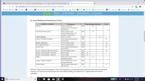

what gaskets need to be replaced after 6 years of burning or 18 tons of burning. I replaced the door gasket. Not sure if any other gaskets need replacing
From your manual...
  • [Hearth.com] Harman accentra 52i
Should not need any gaskets unless you are having a problem. My P38/43 is 16 yrs old and still on all original gaskets
Sent from my iPad using Tapatalk
There is no mandatory gasket change ... my (2015) 52i is on all original except the door gasket and docking as I got the stove used and it sat for a summer in seller’s garage so gasket got stuck to the rest of it due to moisture ..repainted and installed in 2017 , my father is on year 10 of his accentra insert, just replaced the door seal this year, all others still going... just inspect the important ones.
