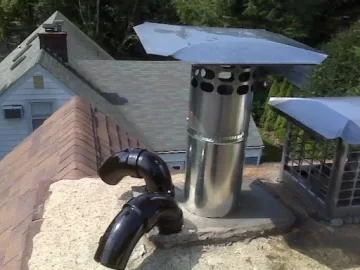

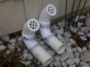

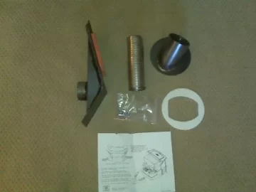

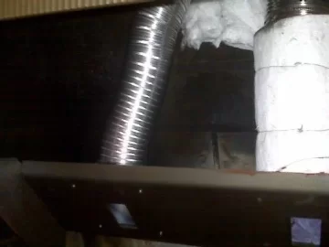

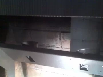

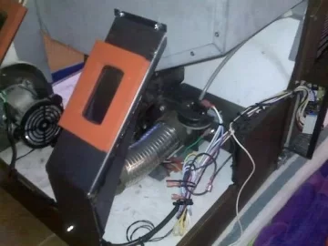

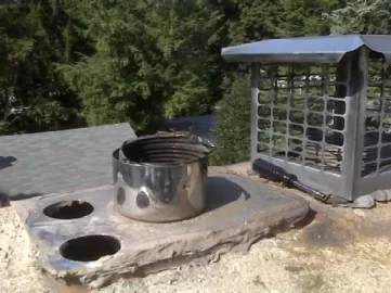

    With careful thought and input from members of the forum, I've finished the OAK for my accentra. Overall it was not that hard to do. I was against going through the back wall of the chimney and cement. So I went up the chimney and put (2) fresh air vents along with raising the exhaust pipe. PVC pipe is 2" with (2) holes drilled in top SS plate. I used the Harman OEM outside air kit and added the 3" pipe which I picked up from HD. The PVC piping and the paint I actually had so no cost for the outside addition. Overall it set me back $110. It took about 3 hours overall from start to finish. Not sure if the pics are going to look good but I did attach a few for members of the forum who are contiplating the OAK.

    Very good info for any brand insert! Using the two parallel OAK pipes cuts the resistance to 1/4 of it's actual length, so that brings the 'allowable' length within reach of the actual length. Of course, people are going to post on here that using PVC pipe is a no-no and violates code. Personally, I can't see why the manufacturers state that it must be metal since it is just drawing outside air....

    Wow, Looks like you did everything correctly. You ran your (looks like 4") exhaust all the way up to the cap and you used the flue around your exhaust flex pipe as your air intake.... As long as you do not have mixing in the flue then I can not think of any reason why that should not work.

    So, did you run the OAK piping all the way up to the two intakes or just terminate it past the smoke shelf? If you stopped at the smoke shelf, did you seal it off with a plate?

    I did not run the 3" pipe up the length of the chimney. I found that probably would be to restrictive in pulling the air. I did plate off the smoke shelf. One thing to note here is YES the air I was pulling was warm. It's the air that's been heated by the exhaust pipe running up the chimney. The draw at the top of the 20' run for the fresh air could barely be felt since it was such a long way to pull air. That might be the reason this set-up didn't work well for me. If you have a clean-out ash well in your fireplace that goes to the outside of the house that might work much better since it's usually a short run like any stand-alone unit would have.

    I only ran the 3" pipe from the back of the stove 3 to 4 feet above the smoke shelf. With inserts the OAK is a tuff decision since the runs are usually long to pull fresh air.
