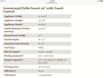

Can someone explain what the three sizes are referring to 20" 22" 24",
When all the dimensions show the same.
Thank you

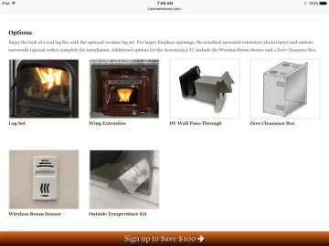

It shows the surround at 41-13/16" x 32-1/8" is that what you get when you buy the insert or are those considered the wing extensions.
Thanks guys.
[Hearth.com] Harman Accentra insert sizes
I think that’s the dimensions of the standard surround that comes with the insert. The wing extensions would somehow expand that surround, I guess for if you had a huge fireplace opening to cover.

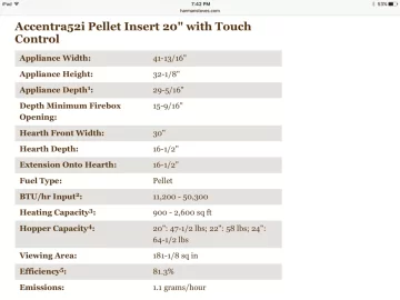

Thanks guys, it is really strange how they are indicating the hopper size, you would think under the 20" chart it would say 20" 47-1/2 Lbs, and on the 22" chart it would say 22" 58 Lbs, not list all three hopper sizes on all three charts, That makes no sense.
What is the sense of having three charts if they are the same.

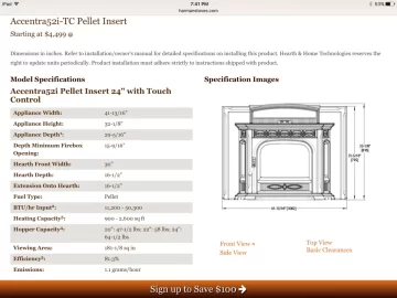

On their website. Side view under specifications.
Former Farmer, thanks for pointing out the view buttons below the image, I totally missed them.
