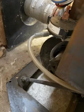

Where is this vac switch located? Is there anyway I can bypass the vac switch to rule that out?
Thanks in advance. Chris
On that not sure where , but should have hose connected to it, and search part number for pic.. To Bypass vac switch- make a jumper wire with Male spade ends. Unplug unit, take a pic of wires on vac switch, note location, use jumper or something to connect 2 wires together . Restart. This is for trouble shooting only.....
Reactions: Narsbars
I bypassed that vac switch and when I plugged it in the feed motor took right off. So do I need a new vac switch?
Check the hose that connects to it for cracks or breaks. if the hose has a leak then it won't activate the vac switch.. May be a good idea to replace that too if need be
Hoses look good. I blew it out with the compressor as well.
  • [Hearth.com] Harman Advance feed auger not working
Did you blow toward the stoves firebox or toward the switch?
