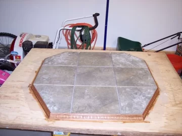

Harman Advance homemade hearth pad under $50 USD
flashbang
Jul 13, 2008
135
NY
free 1 inch plywood
free tile
premix grout $7 USD
premix thinset $17 USD
trim $20 USD
trowel $2 USD
liquid nail glue $3 USD
total cost
$49 USD
Edit: minus $2 trowel that I returned to HD.

:-) Didn't happen to get a FREE stove with the free plywood and free tile did ya?
Nice Job...Looks SUPER!!!!
Looks like you did a really great job! Just hope it's not glued to the plywood table... ;)
Steve
Steve
Hard to see in the first photo, but there is waxed paper around the perimeter to avoid just that. liquid nail tends to ooze out from behind the trim.

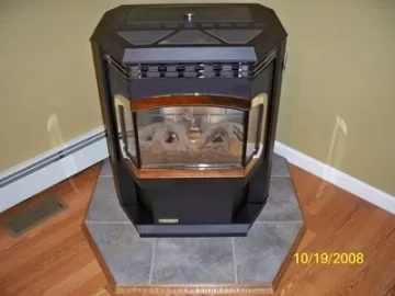

Looks great and you can't beat the price, but does it give you enough clearance? Looks like a 3x3 size pad, unless you used those extra large tiles that are 16x16. My Harman manual says you need at least six inches clearance from the front door. I am overbuilding my hearth, making it 5x5, doing a kitty korner install and didn't want to come up short on any clearances. Had the room to do it as well, so I'll probably have a foot from the front door. Good luck.

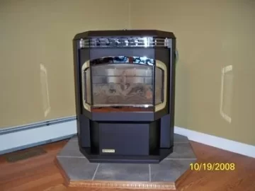

Up and running

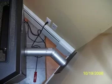

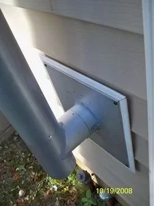

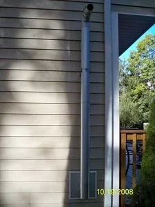

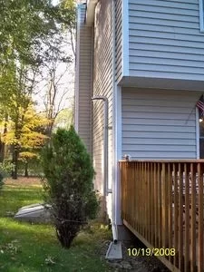

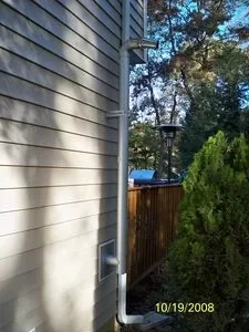

Outside two 3 foot pipes and High performance SS Jet cap w/the high price tag.

looks real nice....
I see you got several heating options going on there.
you may find yourself removing the logset down the road, it interferes with the airwash for the glass
GVA said:
looks real nice....
I see myself removing the $70 log set after I break it trying to clean the glass. If you stare at it too long it wants to break.
