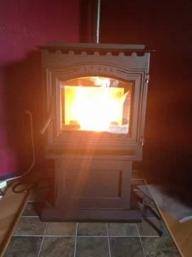

Yea, I agree, there is a new stove smell that needs to burn off, Give it some time before you drive yourself nuts trying to find the exhaust leak, it may not be a leak.I can tell you from experience, when I first started my P68 5 years ago, I swore there was something leaking. Called the dealer, he said it happens to new stoves, a burn-in smell. He said it would be gone within a week and it was.
Tom C.
I ran a bit of clear around mine just to make sure no bugs or rain could find it's way in.Day 3:
1. Assembled stack and painted.
2. Lined up stack (Stood on oven), traced hole, used dry wall saw to form a cross, and used razor to trace the circle.
3. Punch the pie slices, and clean up. Did the same for outside wall but with a hammer/chisel. To line up holes, I cut a starter hole in the center using the thimble as a trace.
4. Put in stack, and clean up! W00T W00T. I did install a OAK (Used a metal dryer vent for outside and a automotive flex tube with a metal hose clamp) No one carried OAK locally.
5. Siliconed around/all over inside thimble.
For termination, you notice how there is a little gap around the duravent, I was wondering if there is a not so red high temp silicone I can use to seal that. The gasket on the inside plate isn't doing the job. It's not that big of deal, but anytime you can stop a little -40 degree air from coming in, thats a good thing.
Today I am borrowing a manometer from work, picking up a black surge protector and will be breaking her in.
dangit, now I have to paint my inside pipes.![]()
I did caulk around it, outside with clear, inside with black. The dura vent thimble gasket is a joke, in my opinion.Absolutely seal the gap between the thimble and the pipe... No air infiltration![]()
