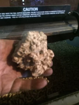

I have seen that happen in a Harmam with wood pellets in the hopper that were so bad they clumped together creating enormous air pockets so no pellets went through the auger. I call them Bee Hive pellets so check for air pockets in your hopper!
See pic below, click to Enlarge
Also I have seen a piece of plastic and leaves cover the opening over the auger chute in the bottom of the hopper so no pellets were dropping into the auger. Bail out the pellets and check.

I evacuated the hopper and believe it was a extra long pellet jamming the slide plate. All seems to be corrected. Thanks Don for the quick response.
