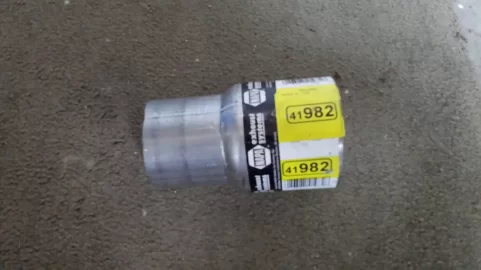

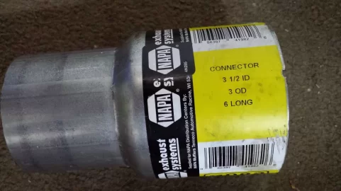

This worked great to make a good fit to a standard stove adapter. Cut about an inch and a half off both sides and put it on the stove with red rtv.
