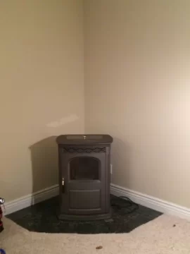

and yes its a full 7 inches from the stovetop to the wall, its a diagonal install. Minimum is 6.25, i couldnt tell if that was from the stovetop or the main stove so I went stovetop since its the closest thing to the wall. Losing the couple inches didn't matter for me as I needed to be that far out to make the thimble work anyway.
Pic of the progress. Need to finish the carpet edge, quarter round moulding on the granite where it meets the wall, and the pesky OAK.
[Hearth.com] Harman metal OAK pipe--looking for leftovers--2ft
Picture is worth a thousand words. I see now with it being the longer run. What a bummer missing by that little bit. Oh well, looks like you pretty well have it handled. Plug stove into a surge protector or the protector police will ding you. Are you doing a UPS (surge w/ battery back up) so your stove will exhaust and shut down properly in a power outage?

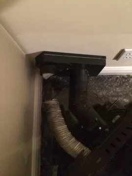

If you still need it, I have a few feet of pipe left over from my OAK install.
Heres what it looks like.
(broken image removed)
@ Tim - Is it 2 3/8 or some other size?
It appears harman has used mutliple sizes on different stoves.
2"
It's from this kit:
(broken link removed)
