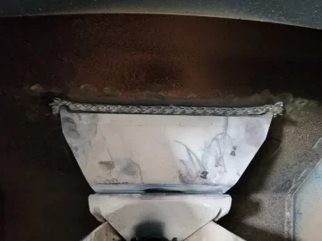

Just had a brand new p35i installed and am experiencing this issue. I have a message out to the dealer but also hoping it's something I might be able to fix myself. I'm hearing mixed things on the powdered graphite... did anyone have true success with silencing it?

Update!!
After chatting with my dealer, I stuck a piece of stove gasket where the top of the flame plate extension meets the back panel of the stove and voila! Noise is gone! Not the ideal solution because this seems like it should be an easy thing to fix with the stove design, but for now the sound is gone. Hope this can help others! The next time I take that piece off to clean I can snap a picture if anyone would find that helpful.
To recap, I had exactly the same noise coming from my p35i after installation as the video posted at the beginning of this thread. With the above solution, the noise is gone.

Thank you for coming back with your results. I think it would be nice if you would post a picture for future readers of this post.

Update!!
Here is what it looks like... just a tucked in gasket behind the plate.

Thank you. I was wondering what the flame plate extension was, now I know.
