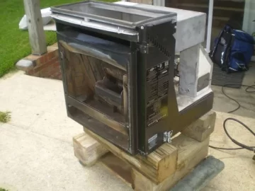

I clean my insert outside on a dolly. I had the cast iron top removed to lighten the load and reinstalled it outside. When I lit the stove I heard the rumble. I noticed the weather stripping sticking out around the hopper (not the lid). After repositioning the gasket the rumbling stopped. Pulled the gasket out, rumble, sealed hopper, no rumble. It is definitely A cause for the rumble.

Okay, here's what I found... the dealer came out and looked at the stove. I left it off so it was cold when they got here. After pulliing it out and inspecting the rear of the stove which all looked good he lit the stove and watched it burn. It didn't take long to start making the rumbling sound... he discovered that by opening the door latch slightly that it would stop... upon further inspection of the door, he decided it may be that the door wasn't making a good seal. The next day he brought another door over from the display unit in the showroom and we quickly took of my door and replaced it with the one he brought. When we started the stove it didn't take long before the rumbling started, and proved the door theory wrong.
I had mentioned the flame guide as suggested by two other contributors to this thread, and he said he had the curved one in his truck if I wanted to try one. So he left one with me and I shut down the stove to let it cool. A few hours later I removed the flat flame guide that came with my P35i, and replaced it with the curved flame guide. I definetly like the way the stove burns much better with the curved flame guide! The rumbling has decreased by 90% and now it is a pleasant rumbling that sounds like a normal fire sound, rather than a sort of resonant frequency vibration that could get very loud and have long durations with the flat flame guide in place.
I also notice that the flame is more consistent across the burn pot and the ash on the edges of the burn pot is more completely burnt with the curved flame guide.
Thanks alot you guys for suggesting the flame guide!... It seems to really improve stove performance and greatly reduce unwanted vibration.

get the flame guide for a new accentra insert and your 35i will work fine. this flame guide has a curve in it that kills the turbulence associated with this noise.
