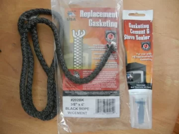

I had to go to dinner with my lady friend. I will change the gasket on the ash door first. stove is working fine just cant hook up the low pressure vacuum switch. got it jumped. the gaskets are the last thing I hope. does anyone know the size of the gaskets on the P43?

I think the P series are 3/8. I've done three in three years. If you can I would recommend the graphite impregnated rope. Seems to self lubricate and not want to stick and get hard and flat as fast as the white stuff.
