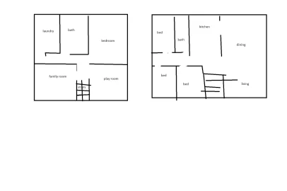

This is my plan and my family room where I will put it

Hi, I went back to the installer and asked him about the p61 and p68. Again I have a split entry about 2600 sq feet- This is what he said- the family room about 12 x 22

Ya, 2600 sq ft total. The thing about the layo
The difference in price between the 43 and 61 is about 980$ total installed. I am still not sure if it's worth it,
It's obvious from your layout plan why the installer is saying what he is. He made his points very clear and in fact you have two installers saying basically the same thing. Basically distribution is your problem more so than stove size. Where in this plan , on what wall and what direction will the stove face ?

The stove will go in the family room on the left wall top corner. I am going to stick with the 43 and order it today.
