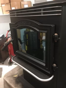

harman P61A door gasket..
Tonyray
Dec 11, 2013
3,613
North of Phila Eagles
checked a few web sites and it seems that the door gaskets I have seen are either white or dark grey.
not sure which to get as mine is getting a bit ragged....[upper door gasket]..
The color really doesn't matter. As long as it is the correct size, installed properly & seals tightly, you are good.
yeah... i assumed that....thnx
The grey is impregnated with graphite. Seems to keep the fibers from crushing and helps keep its form longer in my experience. Worth the effort to use the grey and get a extra couple years out of the gasket job
makes sense...
i just ordered the grey and the gook cement......
thanks..
Couple of our local box stores and farm stores have got in the winter merchandise in and a gasket kit is around $10-12
When inserting into the channel don't pull the gasket but try and push it a bit to make it a bit plumper. A cheap drill powered wire brush makes the job pretty easy after one has pulled the old rope out and chipped out the old cement
Are you going to update to Mirror Glass while you are at it???
