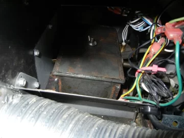

As Harman Lover mentioned above, have you cleaned the fine box out recently? Not the hopper mind you, but the fine box located on the back of the stove just above the combustion motor? Or if you have, is the small lid that covers it placed correctly over the small metal lip on the top of the box?
Others have made the mistake of simply twisting the wind nut down without the cover "seating" correctly at the top and thus not creating a proper vacuum and thereby leading to the stove not running. This is an easy mistake to make as you really need to stick your hand up in there and making sure this lid seats properly before twisting and tightening the wing nut at the bottom of the lid....

I've had this stove for about 10+ years and never knew about the fines box. Now as I look at the picture in the owners in the owners manual I can see it.
Next weeks cleaning will included the fines box.

My son cleaned the stove yesterday and found the fines box was less than 1/2 full. I either got realyl lucky or the pellets I burn don't have a lot of fines. Any way thanks again for all of the help.
