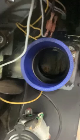

Check the air flapper on the air intake, make sure it’s moving
Reactions: SciGuy
If you have an OAK, it's where that is attached to the stove.
It's located under the left rear shroud, as you look at the stove from the front.
A 5/16 " socket, wrench or nut drive will work for removal.
The location is indicated in the top pic.
[Hearth.com] Harman p68 air flow light blinking
This is a couple photos of the one I picked up last summer, ignore the blue coupler, the flapper is inside.
