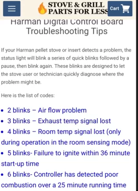

Have a look at these, I would check your burn pot holes to see if they’re all open and not carbon’d up as well as your air intake flapper and path to the burnpot
  • [Hearth.com] Harman p68 shutting off randomly
