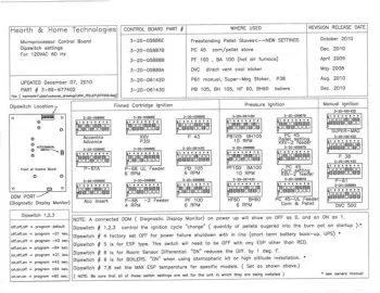

  15. Former Farmer
    Former Farmer
    Feeling the Heat 2.
    Apr 12, 2008
    402
    70
    NE Wisconsin
    Off,Off,On - I have the finned ignitor. I have had to replace my burn pot at least once each year since 2009. I believe my next one will be number 6. I installed mine in December 2008.
    I am going to try setting mine to Off, On, Off to see if this will help with the amount of smoke upon start-up.

    ok i found it, mine is on the front side of the control panel, if you cut out a piece out they are visible without taking the panel off. Mine are by default off on on
    Any suggestions on what to set them to to try to avoid so much smoke at start up?

    Looking on the table above, you are already at the lowest setting for the auger run time.
    Maybe someone else will have some suggestions.

    off off off would be the lowest right?

    No. Off, off, off is the program default. Off, on, on is the program default minus 64 seconds.
