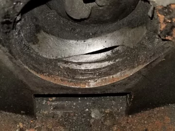

Rona I agree, really good stoves, had a few of them over the years. They do seem to suffer from auger tube erosion unfortunately which is a real joy to fix.

What is auger tube erosion? I have worked with many Harman pc45s since they came out and never seen auger tube erosion? Actually never heard of it. I have had and worked on then since 2004.
Tube erosion occurs at 6-7pm position typically, can happen after auger tip has worn a bit and fire burns back more than usual. It exposes the air feed channel to the auger tube.
I think it's more common on 45's, than 38, 43, 61's, possibly due to horizontal burn pot verses inclined models. Pellets and fire die down quickly on pc45 exposing tip of auger to flame when going to idle mode
Granted it's never stopped me from owning them, but it's a pita to fix correctly (feeder weldment replacement, or welding and machining existing assembly.

What fuel is being burned when this happens? If it is pellets do you use that pellet kit that boosts btus to 50,000? Its strange that I have never seen or heard of this problem. The dealer I worked with had sold close to 100 45s since they were introduced and we never had to replace a auger.
My auger is OEM equipment. My burn pot weldment at the top where flame guides are on newer P Series is a bit chewed up. Still no issue. Not sure why but the guy I bought it from was the original owner and said he only burned corn. Seems more like a bit of rust etc; to me but I wouldn't rule out the corn helping that out. The end of the auger is good and never has been replaced that I know of.

Rona, here are two examples of PC-45 auger tube erosion since you were asking what it looks like.
