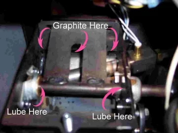

Had the stove installed a couple weeks ago and have learned a lot from all of you prior to my purchase so wanted to maybe just help one other person. As I predicted to myself-- a day after the install there'd be something to drive me crazy- sure enough the ubiquitous squeal everyone has. Taking another day off work to wait for the stove store to come back is not an option so I tried lots of things to remedy to no avail. Just thought I would share how I fixed my squeal. All squeals are different and my squeal might not be your squeal but all squeals keep you up at night. My nails on chalkboard squeal would occur about once per auger revolution. I won't bore you with all my failed attempts- just the success (so far). sorry its a lousy photo.
1) Do the pellet mixed with graphite in baggy shake thing and puff a graphite puff onto the slide plate in the hopper-it can't hurt.
2) Remove right side rear shield and remove the thumbnail screw and remove feeder cover. Contort body to access this area and don't drop flashlight on face- like I did.
3) Place a drop of liquid wrench or other penetrating oil onto the pusher arm where it rotates at the places shown in photo. Sorry- don't know what that support is called.
4) Puff some graphite on the slide plate where shown.
Run on test mode to check for squeal - allow several minutes for it to work.
Well- if it helps one person I'll be happy. Remember- the squeal is almost guaranteed to return- just a matter of when.

Thanks for sharing the experience and your resolution. It's just one more thing to stuff in the back of my mind for "things to check" when the misterious squeal starts.
The pic looks good and informative to me.

Thanks, had the same problem on a Harman XXV. Used a q tip saturated in household oil and rubbed the places indicated. Q tip made it easy to reach without having to take anything apart. Squeal stopped right away.

Thanks alot. This was a simple easy fix. The noise was driving me crazy all weekend. With a little graphite and penetrating oil the stove is quiet as ever. Your description was right to the point and the picture clear and easy to follow. I will get good nights sleep tonight!!! Thanks again.
