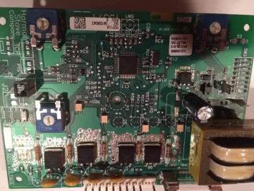

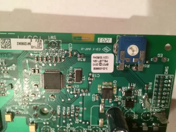

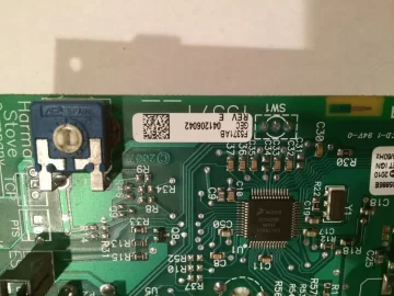

I just took the control board out of my 3 yr old p68 and just like 007 I have Feed pot....100k. Temp control...100k and stove/room auto manual....50k
Good info,is why I reccomended visual verification.Apparently the p38 upgrade is different(which I suspected)but did not know the big stove(p68) is different.Good info,and good luck with repair.
Great pics - thanks for contributing.
