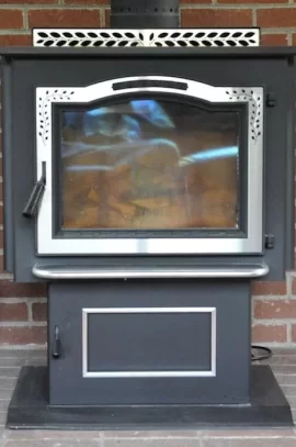

Should I buy this stove to replace my old smoke dragon? Lady says it was only used 4-6 times and then they went to gas. It has the upgraded nickle trim and blower. Any input would be great. Seems like a fancy stove, 2600 is what she said she paid for it. Thanks Pat
Hears the pic she sent me

When I was looking at new stoves this one was way out of my price range but now it's rite in there with the drolet ht2000 and the englander 30. I sure like the looks of the stove. Pat
The TL is a quality heater with a large firebox. It is a downdraft stove so you want to be sure to have really dry wood and there is a learning curve but it should do a good job for you. And that is one heck of a good price for it.
Their is an optional grill and rotisserie available for it also.
Buy it. Get the grill, too.
This stove can work well with the right flue, but it won't be happy with inadequate draft. What are you thinking of connecting it to?
Personally, I wouldn't buy one of these down-draft stoves. I had researched the Harmon stoves quite a bit as they have a good reputation in my area. Couple of friends have their coal stoves and really like them. But I found the down draft system on their wood stoves is finicky, requiring well-dryed wood and an experienced operator. Also, the combustion chamber is fragile and may need replaced every few years. I read too many stories (here on hearth.com) of people who were happy with them but had to burn them super-hot.
I just didn't see the benefit over something super-simple like the Englander NC30. Then I found a used Fireview for $1,000 and my mind was made up... :-)
Like the others said it needs good draft and seasoned wood.
But, with its top load design which allows you to grill is a major plus with this stove.
I do get very good burn times with this stove (10+ hours) using seasoned hardwood.
Well worth $1,200.

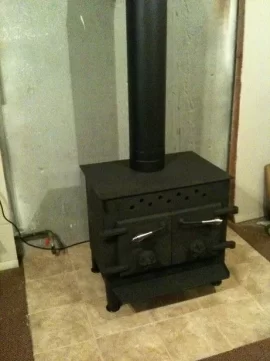

Well I just got home with it. It is in really good shape. I've been using a hurricane. Hears a pic of the old one. Pat
