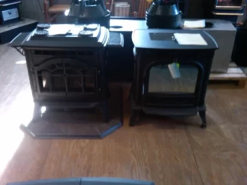

  • [Hearth.com] Harman XXV or Quadrafire Mt. Vernon
kinsman stoves said:
Gee I do not know?
Eric
When you set them next to each other, I actually like the look of the Quad more than the XXV, even though I got a XXV..........
Yes the Quad is a little "easier on the eyes" and has a few more options. Ease of understanding brings the XXV to the top of the list next to the Mt Vernon.
Eric
