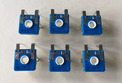

If the board control knobs turn loosely the potentioneters may be worn and have bad spots in them. So it works fine at one temperature setting, but if you move it slightly stove shuts off
What are potentioneters?
they are your adjustment controls on the board

im researching it now. they are soldered on the board, easy=depends on your soldering skills. i have seen them on ebay but prices seem expensive to me, 15-25 bucks for 3 and i know prices for any pot is not $5 a piece. more like $1 ea. so they are marking them up big time.
